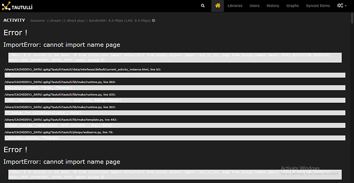

Whenever I update to 2.2.0 or newer, I get this
Downgrading to 2.1.43 makes it behave normal again. So I am stuck at 2.1.43.
Save your database, delete Tautulli and reinstall.
Thanks. A reboot was required between the app removal and reinstall for it to work.
