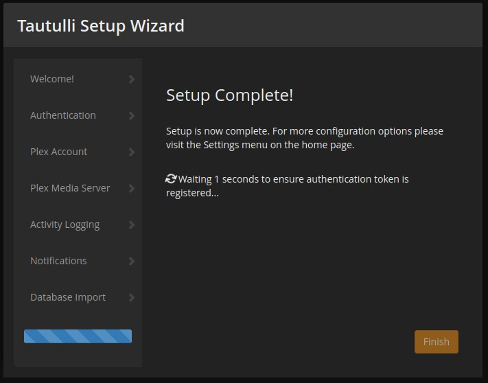

I’ve had Tautulli installed and working on my Linux system for some time, but I hadn’t opened it in a while. I tried to open it a few days ago, and the page simply wouldn’t load (spinner forever). I updated my Linux Mint to 20.3 recently. I can’t swear to it, but it’s possible that the last time I saw Tautulli working correctly was before the 20.3 upgrade.
I tried removing and re-installing Tautulli using Snap. The removal seemed to go fine, and reinstalling progresses to the point where this appears:
But it sits here forever. I don’t know how to proceed.
tautulli.log (13.8 KB)
PMS: 1.25.7.5604
What if you refresh the page or just go directly to /home?
Yes, I forgot to add that. Going /home, it just spins forever without loading the page. That’s where it was when I grabbed the log file.
I’m not sure. Maybe uninstall with sudo snap remove --purge tautulli or deleting the config.ini file from /root/snap/tautulli/common and try again.
I did the remove --purge and re-installed with no change. Then I found the config.ini (a little deeper than you said, at root/snap/tautulli/common/Tautulli). I did the remove --purge again, deleted config.ini, and re-installed, again with no change.
What finally worked was to remove --purge, then delete the entire tautulli folder below root/snap, then re-install. It appears to be working now.
