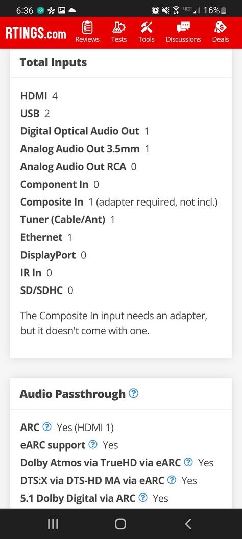

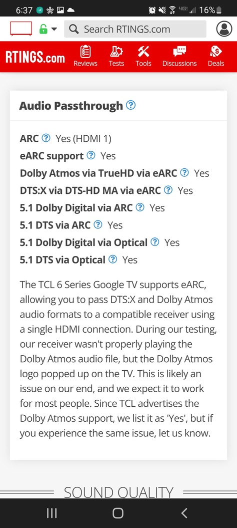

I did this before I made my purchase to ensure all my hardware was fully compatible and it certainly is. Here are some Screenshots from Rtings
@TeknoJunky
according to the pictures above, you may need to use HDMI 1.
if that doesn’t work, I would try them all, or as I already said, plug the shield into the soundbar (if only for testing).
@TeknoJunky
So I don’t have a shield pro yet. But if I do I would try via plugging into the sound system to pass through the audio via earc then that should just throw the video at the TV. I tested with an old roku ultra and that works but that ultra does not support any dts or atmos so I’m trying to make this work via the native Google TV plex app baked into the TV. But! Since this is running Google TV on Android then the manufacturer TCL shouldn’t have any say in the pass through of this app in particular right? As proven by the rtings page and that I can get atmos to work right now just fine and I guess partially dts when selecting optical pass through on plex without an optical cable. The TV and soundbar combo support all of these formats through earc. I did my research pretty good before spending my hard earned money and it should work out of the box so the shield pro is going to be a hard sell to my penny pinching wife considering dts works when I change that pass through setting to optical but not atmos and when using HDMI pass through atmos works but not dts (all while NOT using any optical cable lol)
