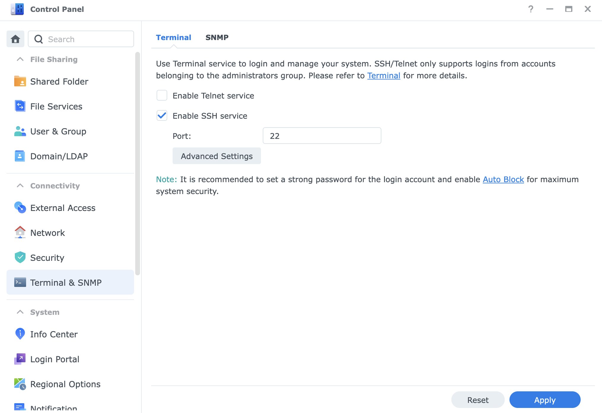

Thank you. Could I just check, as Terminal generated an error. If I have it right, I typed in ssh cinerama21@217.155.223.50 (my NAS user account name and NAS IP address as displayed by my router software) but the error “ port 22: Connection refused “ (did you mean to literally type in ssh adminuser@NAS-IP-Address ? I assume not, as that also generated an error.)
I am definitely in the same folder as where DBRepair.sh lives.
SSH on your Synology is turned off then. On your nas, Control Panel → Terminal & SNMP, Enable ssh.
Did you not read where I instructed you to add -p port number if you changed it in DSM Control Panel > Terminal & SNMP?
If you changed it from the default port number 22, then your instruction would look something like this:
ssh adminuser@NAS-IP-Address -p 55
As pointed out by @TheLivingBubba you do need to enable ssh on the NAS.

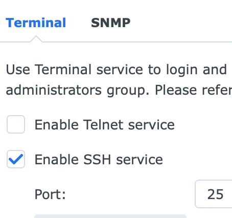

I do have SSH switched in DSM and the port is 25, even the last time I tried it. I am getting the following output in Terminal, so it’s a bit of a puzzle. I am going to back into the thread where I was successful in running the DBRepair script. I think am definitely in the PlexMediaServer folder, where the script lives, but I guess I can’t be. Here’s the Terminal output.:
Mac-mini:PlexMediaServer baward$ ssh cinerama21@192.168.0.22 -p 25
ssh: connect to host 192.168.0.22 port 25: Network is unreachable
Are all of your devices now using 192.168.0.x?
Are you sure your NAS is at 192.168.0.22 and did you Apply after changing the port number in Terminal & SNMP?
