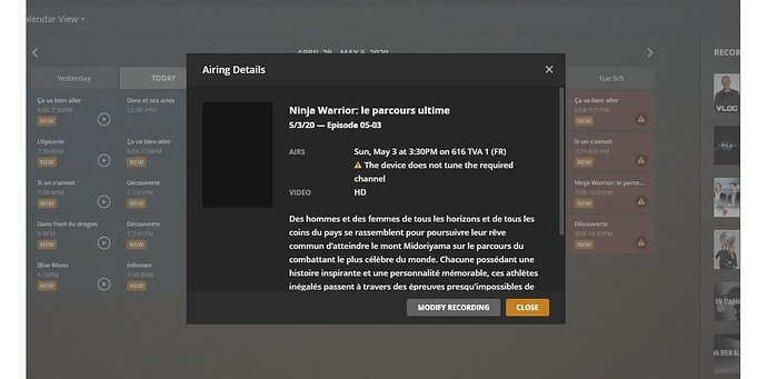

The device does not tune the required channel
Server Version#: 1.19.3.2764
Using XMLTV?: YES
Hello ,
i have another issue since few update… i have this issue :
When i rollback to the version 1.18.7.2457, the issue disappear…

May 07, 2020 09:29:20.718 [24620] DEBUG - Grabber: Operation for 'Ça va bien aller - E20 - Ça va bien aller' on channel 601 completed with status error (The device does not tune the required channel)
We need to get these failures out of the way and then see if there is a tuning issue.
