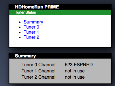

while Plex is trying to tune, I can see in my HDHR status page that a tuner tuned into ESPN:
25%20PM
Then of course it fails and the tuner goes back to ‘not in use’. If I tune in via HDHR viewer, it is all good.

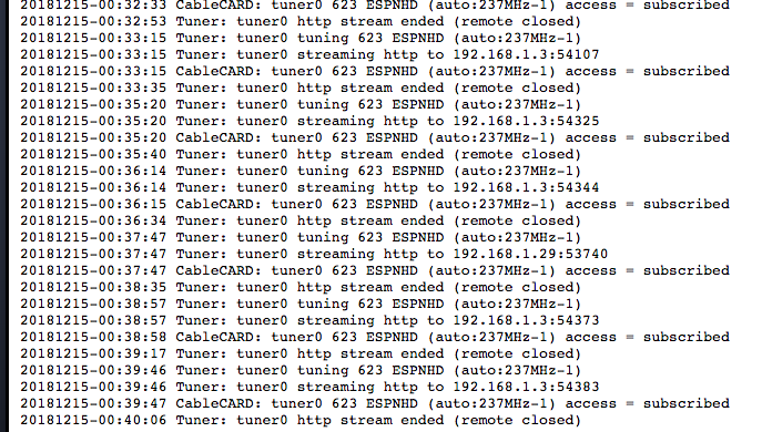

Also here is my HDHR tuner log while I was trying to tune (which looks good to me):
41%20PM
