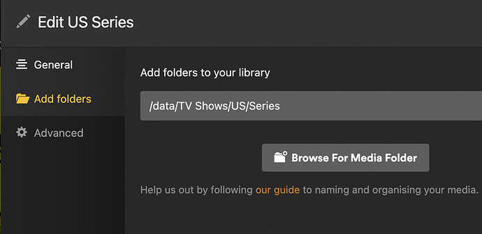

What folder path did you add to plex? (Please show screenshot)
Plex is from the PlexMediaServer container but the Plex library is the same for all the tv series: /data/TV Shows/US/Series
Series is managed in Sonarr, and the path used is the same path as all other tv series.
