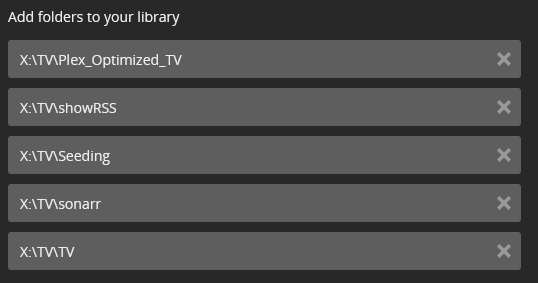

@Sucalakafufu can you provide a screenshot of the library => Edit => Add folders screen for that library?

I don’t think Sonarr has a permissions option for Windows. The permissions on the folders are correct and have never been an issue with Plex before the update. I am not using a Synology for storage.
All errors outside of the “X:TV\TV” directory can be ignored. I apologize if that is confusing in the logs. “X:\TV\showrss” is another automated directory. Files get put here then renamed. I currently have “Empty trash” turned off on scans as I troubleshoot so Plex will still have these errors until I empty the trash.
The library where I would focus is “X:\TV\TV” if we are looking through logs. Permissions have not changed since before the Plex update and suddenly Plex does not like subfolders after adding a new file to them. If you do not add or remove anything from a subfolder, Plex still remembers all files.
Can you provide an example of something under X:\TV\TV that is missing from the logs you pointed to?
