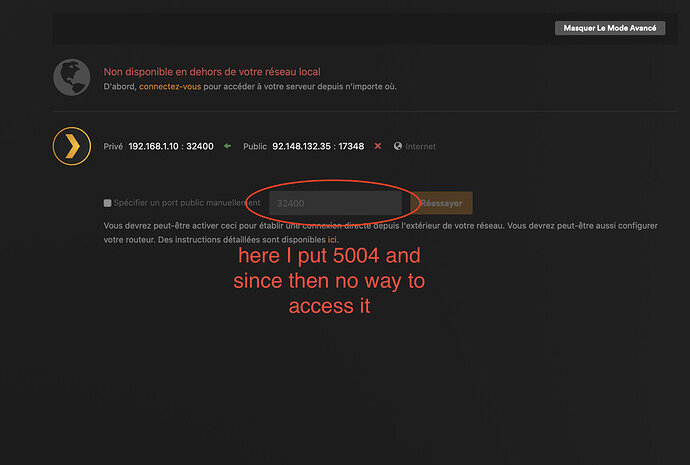

My NAS Synology DS415+ until yesterday Plex had been working for more than 3 years. I made a mistake in the remote access settings. Instead of the standard port 32400 I put 5004. (But 5004 was used to Connect dsm https)
After validation my server is no longer accessible and there is no way to change the parameter since it tells me “The “NaSam” server is inaccessible. Check that the server is working, also check the network, then try again.” I tried to start again by deleting Plex Media Server from the NAS (deleting EVERYTHING) and deleting the media server from my account in my devices.
I recovered with the Token (Plex/claim) it tells me that it is recovered and when I connect it is still inaccessible.
Can I reset the port setting to 32400 in another way? without having access to it?

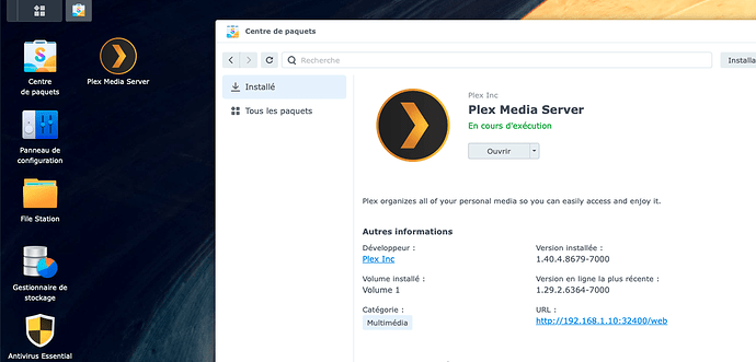

When you look in Package Center, is Plex running?
If it is, please stop Plex.

I used claim Token by installing PMS Tuesday with the Message « claim successfully Samfiles ».
Thuesday i try to connect with http://192.168.1.10:32400/web (but Not in private Mode) but it didn’t work. I will try private mode this evening After my work.
Should i uninstal PMS and install New with claim Token again before i try to Connect with privat Mode?
EDIT : I open an incognito (private) browser safari then open the NAS by it’s LAN IP (http://192.168.1.10:32400/web but it connect me to new server “Robert” that I create without wanting to.
The old server cannot be reached…
In summary, my old server is no longer accessible from my account for I don’t know what reason.
The IP of my NAS is fixed 192.168.1.10 and when I try to connect with the address http://192.168.1.10:32400/web it adds another server that I call “Robert” for the differentiate.
Here are some screenshots that may give some additional information…
Thank you for your help
