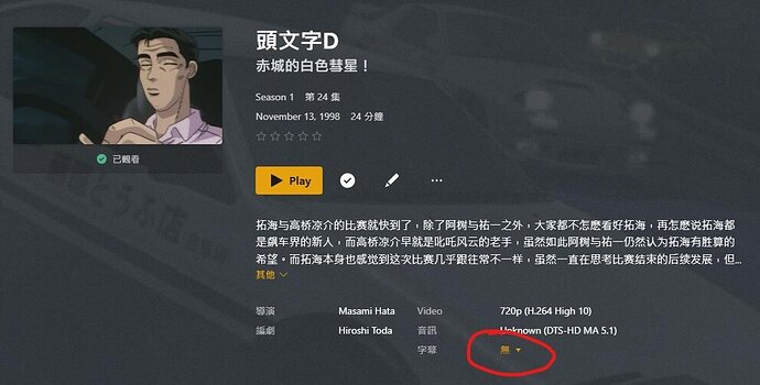

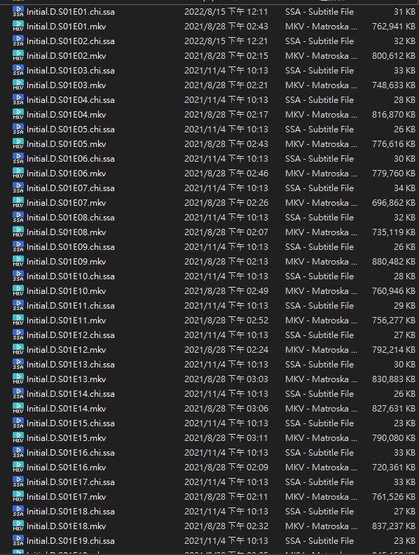

I was using it yesterday and for some reason I refreshed my PLEX database and my subtitle files didn’t detect the .ass or .ssa subtitle files.
.chi.ass or .zho.ass both tried to detect the subtitle file.
And it’s not just one animation, it’s several. i need help!~~~
When I refresh, the presence of .ass and .ssa subtitle files for the animations I’ve encountered prevents my server from detecting the subtitle files.
I am at a loss and in need of technical support. Should I reinstall DSM PLEX server or take a different approach? Please advise.
