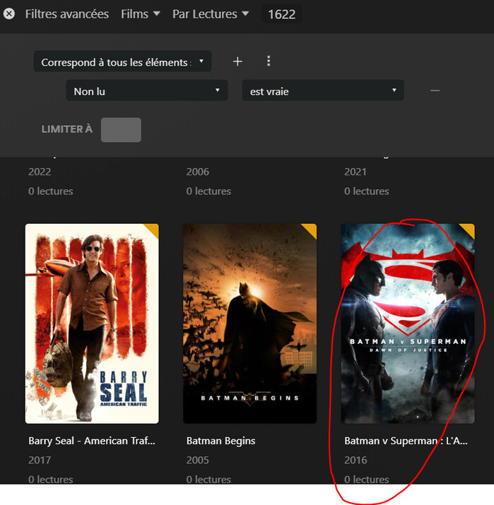

I’m experiencing an issue with the “Watched Status” feature in Plex. The watched status for movies is not updating correctly, showing 0 plays for films that both myself and my users have watched. I would like to report this as a bug and seek assistance in resolving it.

Observed behavior:
The “Watched Status” remains at 0 plays for movies that have been watched by both myself and my users. This issue occurs consistently and is affecting the usability of the feature.

The movie was watched by a user. At least that’s what the history tells me in Plex. This user is not me, but when I run the search with the filter, it should note “1 reading”

I don’t think the filters apply to any other users except for you
You’re using an advanced filter that you created inside your server that only keeps track of you and your watched history.
