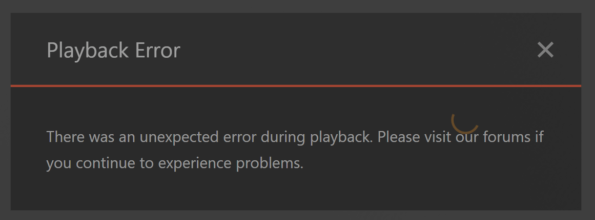

After auto updating (is it possible to stop this?) from 1.86 to 1.87 on my MacBook of all (least as many as I have tried) it stops playing after a few minutes (is variable) with the following message:
Playback Error
There was an unexpected error during playback. Please visit out forums if you continue to experience problems.
If you close it and start playing the media again it works straight away and then another few minutes and it stops with same message.
All media works on the previous version and also on Apple TV, and iOS devices so it is def the updated version and when I roll back to the originally installed version.
I keep rolling back to the originally otherwise I can’t watch anything on my Mac, but it keeps forcing an upgrade when you restart it.
