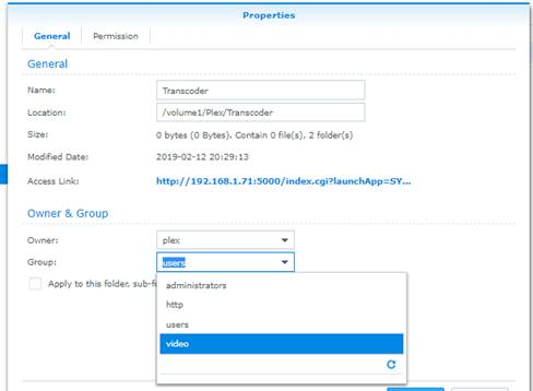

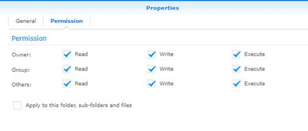

Alexh07,
I created a folder under Plex directory called Transcoder, Owner is ‘Plex’ Group is ‘User’, no option to make Group also ‘Plex’. Both permissioned for rwx, still get transcoder error, see images. I am using a Synology NAS.
You may want to attempt the commands that I was mentioning via the CLI. You can find information on how to access that below. Then you can issue “groups plex” to find out what groups the user plex is in. If you navigate to the parent and issue “ls -lah” this will let you know the permissions currently set on the directory.
https://www.synology.com/en-global/knowledgebase/DSM/help/DSM/AdminCenter/system_terminal
