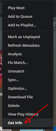

Is there a way I can see what the bitrate of the file is and how would I find out whether the TV can handle that?
you can find the bitrate/details of any video file with ‘mediainfo’ (google it).
within plex, you can ‘get info’
