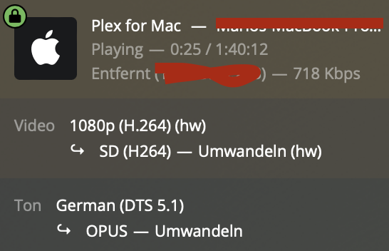

hardware encoding is activated and does its job as you can see in the screenshot attached.
as i said already… those errors happens aswell if there is no video transcoding …
Bildschirmfoto 2022-03-17 um 20.05.38
