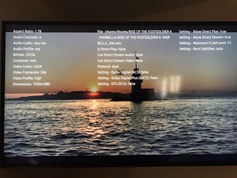

The other thing I’ve noticed since the upgrade is that the TV (its a 2016 UHD KS8000) on some bluray rips says the video is being transcoded. when in fact the server is using direct play. See attached photos → TV shows Can Direct Stream video → FALSE!

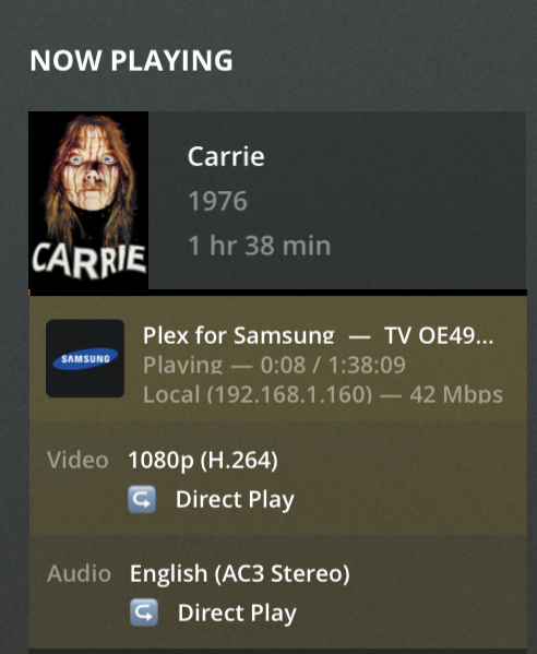

Using the sample file that wasn’t working, I had no issues:
Is your subtitles off? The default subs was PGS and that will kick off a transcode. Also check your settings to see if Direct Stream is enabled
You can see the working file, so what is the difference between them, the working one direct plays and has subtitles, yet does not transcode.
Here are the two files with info on screen.

Just updated to 4.21.2, same thing, Samsung Q70R, this TV doesn’t support DTS so should only transcode audio, yet is doing both.
Change the audio on the track to ac3, then it doesn’t transcode either.
Just did a few more tests of blu ray discs, again, some work as they should others don’t. I can’t explain the difference between files that work and ones that don’t, but it’ definitely never transcodes both if the audio can be played natively. The two files I included above still produce the same results, can you not examine those to find out the difference?
are subtitles enabled?
audio transcoding + subtitles = video transcoding
