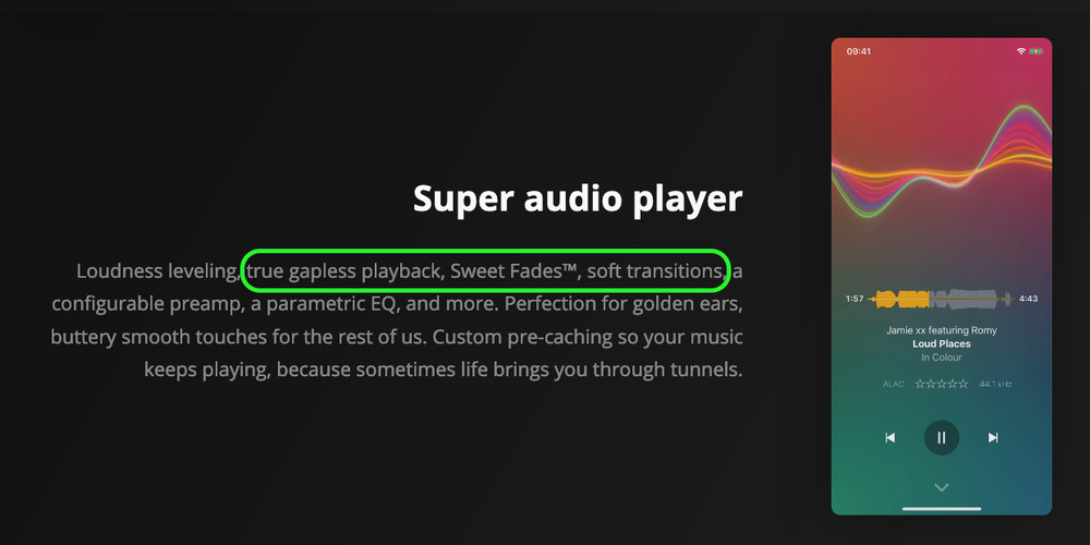

Allow me to illustrate some of the confusion. But before I begin, thanks to your response, I do have a better understanding of what the differences are between gapless playback and Sweet Fades™ so, thank you for the clarification.
What was a bit confusing initially (and how I read it) to me was that, true gapless playback, Sweet Fades™, and soft transitions were all synonymous. It was confusing because that’s how well Sweet Fades™ was working. I’ll update my previous post with some new findings that I have to keep everything concise; essentially, true gapless playback is working for me. In the meantime, can we re-write the copy and/or documentation to better reflect the differences between the three?
Yes, I was able to realize this some time ago after importing music wherein I would have to wait until the scheduled tasks ran when the sound prints were generated. Rest easy, the tracks I have been testing in my initial post all have their sound prints.
However, it is still unclear as to whether Sweet Fades™ is client side or server side. According to Elan’s reply, Sweet Fades™ is client side whereas, a reply from one of the Plexamp techs on Google Play Store stated that the feature is server side.
Both of those people are me :slight_smile:
The server needs to compute data for Sweet Fades; if it does, you’ll also get the seek print as an easy confirmation. The client may enable or disable sweet fades.
Gapless playback needs no analysis whatsoever.
