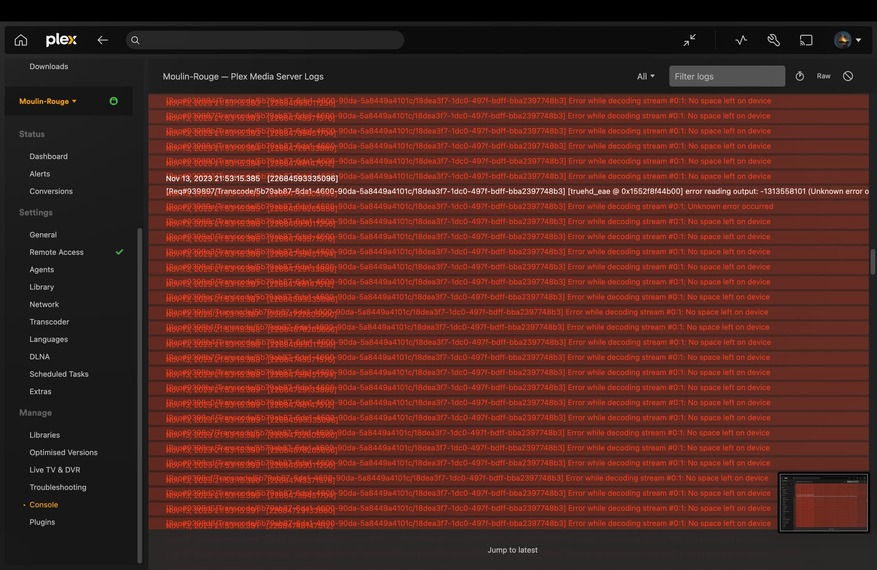

TrueHD audio transcoding BUG = error not enough space
Server Version#: Version 1.32.8.7639
[Req#a90a78/Transcode/8eec47ad-65ea-4809-99dd-75f14426389e/6ecc144f-085f-4002-80dd-18545f461b37] Error while decoding stream #0:1: No space left on device
[Req#939830/Transcode/5b79ab87-6da1-4600-90da-5a8449a4101c/18dea3f7-1dc0-497f-bdff-bba2397748b3] [truehd_eae @ 0x1552f8f44b00] does not start with major sync!
This bug seems fairly new but it could just be the first time I have some shows using TrueHD audio?
Anyway I have no idea why this affects generating still thumbnails & chapter markers. I have all audio analysing turned off.
Any advice? It generates this infinity log of errors & keeps the drive spun up while it try to access these files. It only happens from the series LOST. The served has over 22TB of films and only this series creates this problem.
