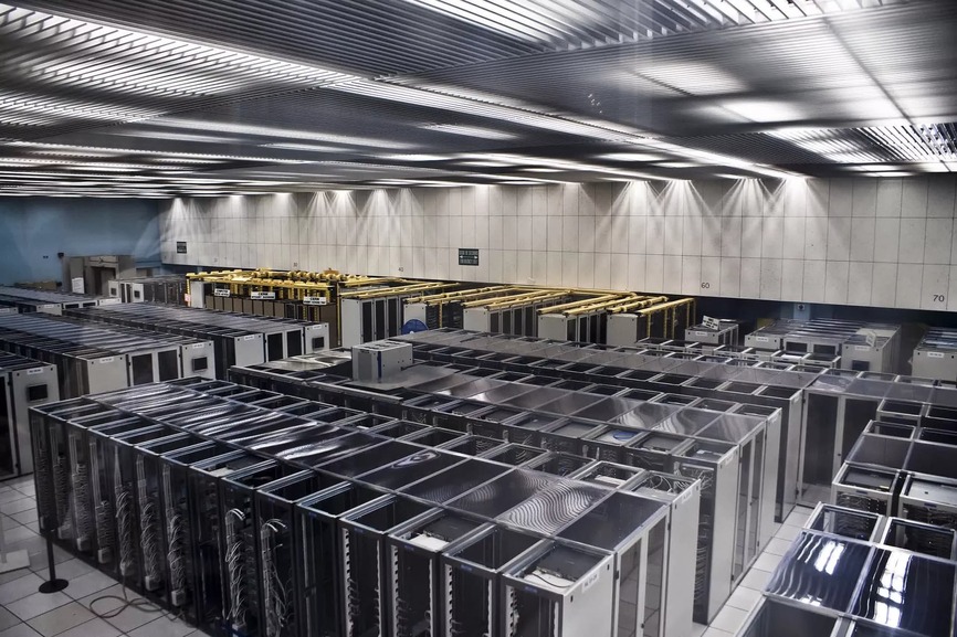

I don’t Plex stream to my phone often, never understood why I’d want to watch a video on a tiny screen when I have a 65" TV. The only times are when I’m at a doctor’s office and usually the wifi is subpar.
Your server
Netflix server
Other streaming services don’t work the same way Plex does. They can afford to send out multiple versions of the same content that’s already been converted to a size and format that fits your device
If you stream a 4k video with Plex to your phone, your server has to convert that to a lower quality and bandwidth on the fly in real time. In your case, on a 4th gen CPU with no dedicated GPU. You don’t have to go much over 93% CPU to start having some very noticeable problems
