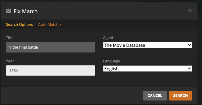

The first step in fixing it to be like TheMovieDB has is to Split Apart the show. it will split apart based on the folder they are in on your computer.
after they are split apart I can tell in this case based on the number of episodes which is which.
so for the one with 2 episodes I do a fix match and select search option at the top of that window. making sure the year is the correct 1983 and that I have changed the agent to themovieDB
selecting the top one listed as 1983 in the results.
After that I went in and edited the metadata so it actually said V the Miniseries
then did similar for the one with three episodes that is the Final Battle ( luckily TheMovieDB has that ones name spelled out

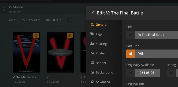

v test 7
Now, can I arrange the 3 folders so that I have Mini Series, Complete Series, and then Final Battle?
Edit the Sort Title field in the metadata to something that will work alphabetically
In this example I changed the sort titles to V01, V02, and V03
