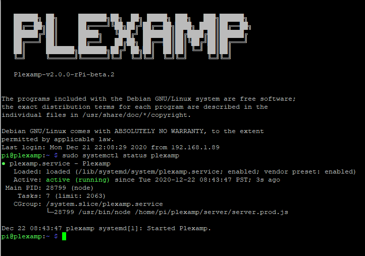

I’ve tried to update nodejs and configured my token (taken from PlexAmp v1 running on windows) but I’ms still getting the following error when I try to start the service.
Can anyone make any suggestions on next de-bugging steps? (disclaimer - I’m fairly out of my depth here - enough knowledge to be dangerous.)
FYI - nodejs version is v9.11.2
I made progress getting the service running on RPi, but I cannot get it to show up as a player.
Any ideas of what or how to check that?

I followed the instructions of doing a fresh install of Plexamp v1.1.0 and grabbing the server.json file from there. Made sure to use the correct version of nodejs, and confirmed the service is happily running using systemctl status plexamp
The problem is I cannot see the player.
Any suggestions?

root@plexamp:~# systemctl status plexamp
● plexamp.service - Plexamp
Loaded: loaded (/lib/systemd/system/plexamp.service; enabled; vendor preset: enabled)
Active: active (running) since Tue 2020-12-22 11:17:39 PST; 4s ago
Main PID: 5678 (node)
Tasks: 7 (limit: 2063)
CGroup: /system.slice/plexamp.service
└─5678 /usr/bin/node /home/pi/plexamp/server/server.prod.js
Dec 22 11:17:39 plexamp systemd[1]: Started Plexamp.
root@plexamp:~# ss -l -p -n |grep “pid=5678”
root@plexamp:~#
This is the output - isn’t the status where I get the pid?

Dec 22 12:40:31 plexamp node[10641]: at Object.Module._extensions…js (internal/modules/cjs/loader.js:789:10)
Dec 22 12:40:31 plexamp systemd[1]: plexamp.service: Main process exited, code=exited, status=1/FAILURE
Dec 22 12:40:31 plexamp systemd[1]: plexamp.service: Failed with result ‘exit-code’.
Dec 22 12:40:31 plexamp systemd[1]: plexamp.service: Service RestartSec=100ms expired, scheduling restart.
Dec 22 12:40:31 plexamp systemd[1]: plexamp.service: Scheduled restart job, restart counter is at 1327.
Dec 22 12:40:31 plexamp systemd[1]: Stopped Plexamp.
Dec 22 12:40:31 plexamp systemd[1]: Started Plexamp.
Dec 22 12:40:37 plexamp node[10648]: /home/pi/plexamp/server/node_modules/bindings/bindings.js:83
Dec 22 12:40:37 plexamp node[10648]: throw e
Dec 22 12:40:37 plexamp node[10648]: ^
Dec 22 12:40:37 plexamp node[10648]: Error: The module '/home/pi/plexamp/server/node_modules/serialport/build/Release/seri
Dec 22 12:40:37 plexamp node[10648]: was compiled against a different Node.js version using
Dec 22 12:40:37 plexamp node[10648]: NODE_MODULE_VERSION 59. This version of Node.js requires
Dec 22 12:40:37 plexamp node[10648]: NODE_MODULE_VERSION 64. Please try re-compiling or re-installing
Dec 22 12:40:37 plexamp node[10648]: the module (for instance, using npm rebuild or npm install).
Dec 22 12:40:37 plexamp node[10648]: at Object.Module._extensions…node (internal/modules/cjs/loader.js:807:18)
lines 1-62…skipping…
– Logs begin at Tue 2020-12-22 09:55:24 PST, end at Tue 2020-12-22 12:40:44 PST. –
Dec 22 12:40:17 plexamp systemd[1]: plexamp.service: Service RestartSec=100ms expired, scheduling restart.
Dec 22 12:40:17 plexamp systemd[1]: plexamp.service: Scheduled restart job, restart counter is at 1325.
Dec 22 12:40:17 plexamp systemd[1]: Stopped Plexamp.
Dec 22 12:40:17 plexamp systemd[1]: Started Plexamp.
Dec 22 12:40:24 plexamp node[10634]: /home/pi/plexamp/server/node_modules/bindings/bindings.js:83
Dec 22 12:40:24 plexamp node[10634]: throw e
Dec 22 12:40:24 plexamp node[10634]: ^
Dec 22 12:40:24 plexamp node[10634]: Error: The module '/home/pi/plexamp/server/node_modules/serialport/build/Release/serialport
Dec 22 12:40:24 plexamp node[10634]: was compiled against a different Node.js version using
Dec 22 12:40:24 plexamp node[10634]: NODE_MODULE_VERSION 59. This version of Node.js requires
Dec 22 12:40:24 plexamp node[10634]: NODE_MODULE_VERSION 64. Please try re-compiling or re-installing
Dec 22 12:40:24 plexamp node[10634]: the module (for instance, using npm rebuild or npm install).
Dec 22 12:40:24 plexamp node[10634]: at Object.Module._extensions…node (internal/modules/cjs/loader.js:807:18)
Dec 22 12:40:24 plexamp node[10634]: at Module.load (internal/modules/cjs/loader.js:653:32)
Dec 22 12:40:24 plexamp node[10634]: at tryModuleLoad (internal/modules/cjs/loader.js:593:12)
Dec 22 12:40:24 plexamp node[10634]: at Function.Module._load (internal/modules/cjs/loader.js:585:3)
Dec 22 12:40:24 plexamp node[10634]: at Module.require (internal/modules/cjs/loader.js:692:17)
Dec 22 12:40:24 plexamp node[10634]: at require (internal/modules/cjs/helpers.js:25:18)
Dec 22 12:40:24 plexamp node[10634]: at bindings (/home/pi/plexamp/server/node_modules/bindings/bindings.js:76:44)
Dec 22 12:40:24 plexamp node[10634]: at Object. (/home/pi/plexamp/server/node_modules/serialport/lib/bindings.js:
Dec 22 12:40:24 plexamp node[10634]: at Module._compile (internal/modules/cjs/loader.js:778:30)
Dec 22 12:40:24 plexamp node[10634]: at Object.Module._extensions…js (internal/modules/cjs/loader.js:789:10)
Dec 22 12:40:24 plexamp systemd[1]: plexamp.service: Main process exited, code=exited, status=1/FAILURE
Dec 22 12:40:24 plexamp systemd[1]: plexamp.service: Failed with result ‘exit-code’.
Dec 22 12:40:24 plexamp systemd[1]: plexamp.service: Service RestartSec=100ms expired, scheduling restart.
Dec 22 12:40:24 plexamp systemd[1]: plexamp.service: Scheduled restart job, restart counter is at 1326.
Dec 22 12:40:24 plexamp systemd[1]: Stopped Plexamp.
Dec 22 12:40:24 plexamp systemd[1]: Started Plexamp.
Dec 22 12:40:31 plexamp node[10641]: /home/pi/plexamp/server/node_modules/bindings/bindings.js:83
Dec 22 12:40:31 plexamp node[10641]: throw e
Dec 22 12:40:31 plexamp node[10641]: ^
Dec 22 12:40:31 plexamp node[10641]: Error: The module '/home/pi/plexamp/server/node_modules/serialport/build/Release/serialport
Dec 22 12:40:31 plexamp node[10641]: was compiled against a different Node.js version using
Dec 22 12:40:31 plexamp node[10641]: NODE_MODULE_VERSION 59. This version of Node.js requires
Dec 22 12:40:31 plexamp node[10641]: NODE_MODULE_VERSION 64. Please try re-compiling or re-installing
Dec 22 12:40:31 plexamp node[10641]: the module (for instance, using npm rebuild or npm install).
Dec 22 12:40:31 plexamp node[10641]: at Object.Module._extensions…node (internal/modules/cjs/loader.js:807:18)
Dec 22 12:40:31 plexamp node[10641]: at Module.load (internal/modules/cjs/loader.js:653:32)
Dec 22 12:40:31 plexamp node[10641]: at tryModuleLoad (internal/modules/cjs/loader.js:593:12)
Dec 22 12:40:31 plexamp node[10641]: at Function.Module._load (internal/modules/cjs/loader.js:585:3)
Dec 22 12:40:31 plexamp node[10641]: at Module.require (internal/modules/cjs/loader.js:692:17)
Dec 22 12:40:31 plexamp node[10641]: at require (internal/modules/cjs/helpers.js:25:18)
Dec 22 12:40:31 plexamp node[10641]: at bindings (/home/pi/plexamp/server/node_modules/bindings/bindings.js:76:44)
Dec 22 12:40:31 plexamp node[10641]: at Object. (/home/pi/plexamp/server/node_modules/serialport/lib/bindings.js:
Dec 22 12:40:31 plexamp node[10641]: at Module._compile (internal/modules/cjs/loader.js:778:30)
Dec 22 12:40:37 plexamp node[10648]: Error: The module '/home/pi/plexamp/server/node_modules/serialport/build/Release/serialport
Dec 22 12:40:37 plexamp node[10648]: at Module.load (internal/modules/cjs/loader.js:653:32)
Dec 22 12:40:37 plexamp node[10648]: at tryModuleLoad (internal/modules/cjs/loader.js:593:12)
Dec 22 12:40:37 plexamp node[10648]: at Function.Module._load (internal/modules/cjs/loader.js:585:3)
Dec 22 12:40:37 plexamp node[10648]: at Module.require (internal/modules/cjs/loader.js:692:17)
Dec 22 12:40:37 plexamp node[10648]: at require (internal/modules/cjs/helpers.js:25:18)
Dec 22 12:40:37 plexamp node[10648]: at bindings (/home/pi/plexamp/server/node_modules/bindings/bindings.js:76:44)
Dec 22 12:40:37 plexamp node[10648]: at Object. (/home/pi/plexamp/server/node_modules/serialport/lib/bindings.js:
lines 1-69
so looks like a nodejs issue with the service constantly stopping and restarting?
it is showing
root@plexamp:~# nodejs -v
v10.21.0
I went through it before and down versioned it, but somehow it must have updated
