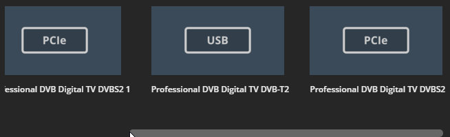

I have 3 tuners DVBSky S952 (V3)/T330/T9580
I think it takes the first thing its sees (DVB-T/T2/C/S2) and assumes that rest are all the same
