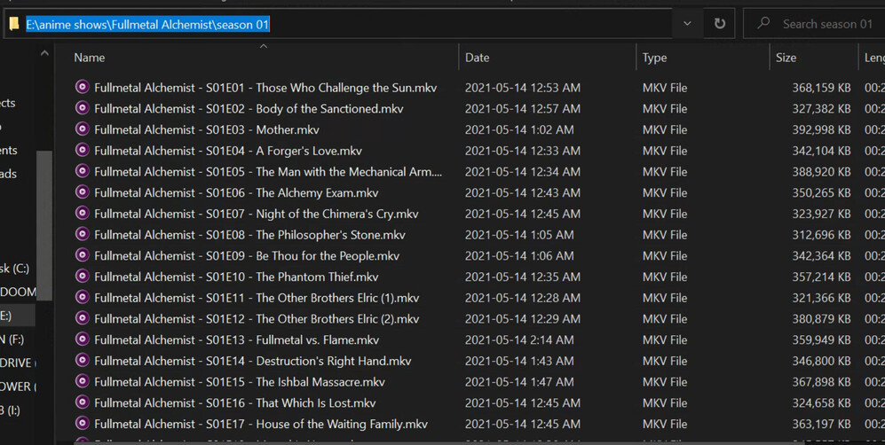

Here is what the main folder looks like in my OS:
And within the season 01 folder:

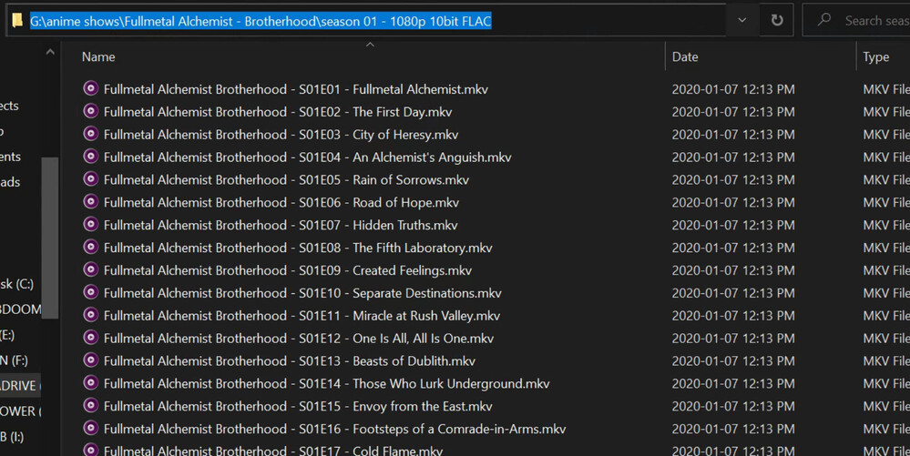

I took the time to set what I thought was a good naming scheme for FullMetal Alchemist: Brotherhood to avoid these kind of issues but I guess something is wrong there? Here is what my FullMetal Alchemist: Brotherhood folder looks like:
And inside season 01:
Should they be named a different way to make sure Plex can make the difference between the two?
