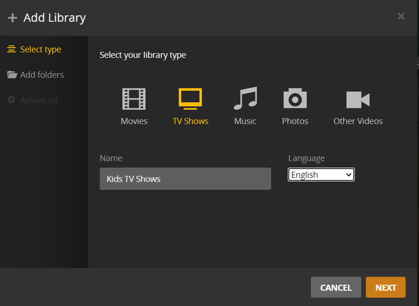

So, I installed RASPLEX using the tutorial and it seems to be all fine and dandy BUT whenever I add a library, the server stops working. I just added a new library of type TV SHOW and mapped to the NAS folder, that appears in the web interface correctly.
Once I do that and it starts scanning, the server crashes. A status check shows this:

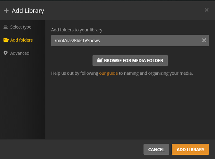

This time around, I left everythign as it is, I didn’t change anything in the settings and it still does not scan the files. Note that the media files are on a mounted NAS drive at /mnt/nas/TVShows, for example. The reason I tried putting the root user was to see if it was not read/write access but I also created the plex and pi users on the NAS and it does not seem to be an access issue.
