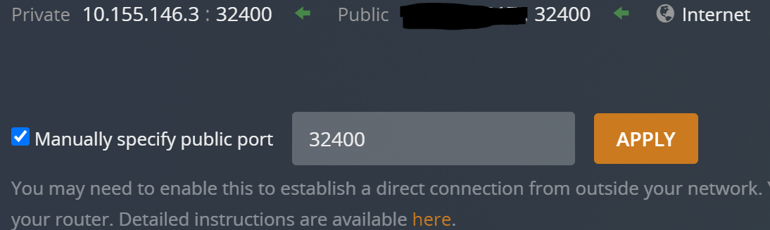

I am running 2 Plex servers on my network as well… here is what my routers forwarding rules look like.
The 1st port is the external WAN port, the second is the internal LAN port.
This is how the remote access settings look in Plex;
and the other machine;
I know your router will be different but it should have some similar function.
Middle port would be irrelevant
Change the bottom one. WAN port should be something other than 32400 like 32500 and Lan port will be 32400.
Probably using notation like WAN 32500:32500 LAN 32400:32400
