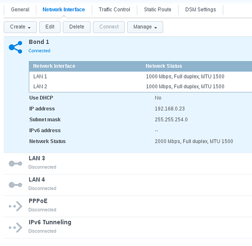

Bonding multiple adapters together is easy. You “Create” a ‘802.11ad’ aggregate adapter… not the redundant one.
It looks like this when done. (I have eth0 + eth1 as bond0 giving 2 Gb/s) the others are normal 1GbE.
