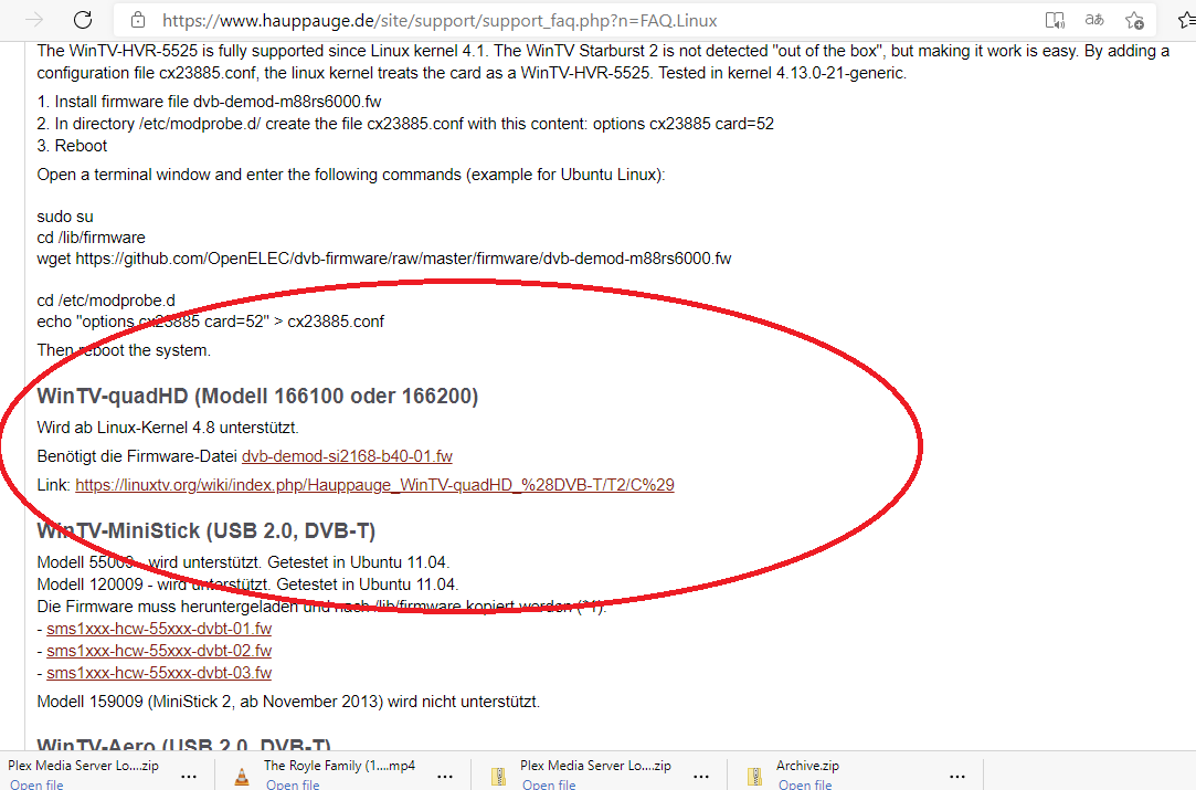

What we have outstanding for linux is to get Hauppauge to update their info web pages in relation to firmware
They have done it on the german web site here Hauppauge DE | Support FAQ but not for the others
Worth checking if it is just firmware issue
Thanks @DrSmith for your reply. Looks like next plan of action is firmware.
@sa2000 Are you saying get the firmware from the German site?

The german web site has the link for the firmware

Thanks sa2000, I wasn’t sure if firmware was country pacific.

sa2000,
I have the file… dvb-demod-si2168-b40-01.fw
Even after following the link, I am not sure what to do with this file?
Lee
https://www.linuxtv.org/wiki/index.php/Hauppauge_WinTV-quadHD_(DVB-T/T2/C)
If I remember correctly from a while back when I was getting my HVR-2200’s to work, you need to copy the firmware to the /lib/firmware directory. Once done, maybe try a reboot and check the kernel output like the above link shows to see if it’s working. Or else just try running a channel scan again. I have the QuadHD ATSC model which doesn’t need additional firmware. I’m also pretty positive you don’t have to do anything with the PPA’s as they are incorporated into the latest ubuntu versions since like 18.04 or something like that. Let me know if you get it working.
@sa2000,
This firmware dvb-demod-si2168-b40-01.fw fixed my problem. I copied it to /lib/firmware directory and rebooted,
https://www.hauppauge.de/site/support/support_faq.php?n=FAQ.Linux
Thanks for all your help
Lee
