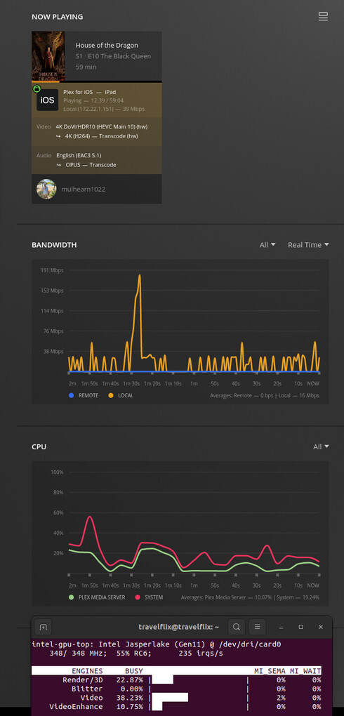

I upgraded the kernel from the default 5.15.0 to 5.18.0 on Ubuntu 22.04 and the HW transcoding worked on the PMS 1.29.2 preview you were kind enough to share with me above. 4K HEVC HDR10 to 4K H.264 40mbps transcode is only using ~20-25% CPU in total on the system.
I’m going to stick with these versions for now until the official PMS release catches up. Thanks for all your help @ChuckPa

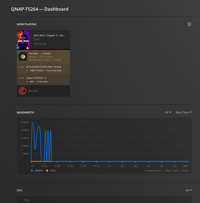

If I may add here. This is keeping it as simple as can be with no tuning whatsoever required.
  1. PMS version - 1.29.2
  2. Processor - N5105
[~] # cat /proc/cpuinfo | grep 'model name' | uniq
model name	: Intel(R) Celeron(R) N5105 @ 2.00GHz
  1. Kernel - 5.10.60 (qnap generic)
[~] # uname -a
Linux QNAP-TS264 5.10.60-qnap #1 SMP Sat Oct 22 01:04:01 CST 2022 x86_64 GNU/Linux
  1. PMS HW transcode and tonemapping
QNAP does not allow kernel tuning so this is as stock as it gets.
