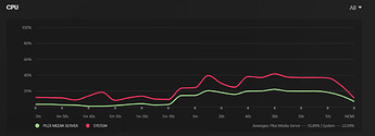

here also my current log as well i tried 3 4k transcodings and it was done very easily
Plex Media Server Logs_2022-12-13_23-48-35.zip (1.8 MB)
