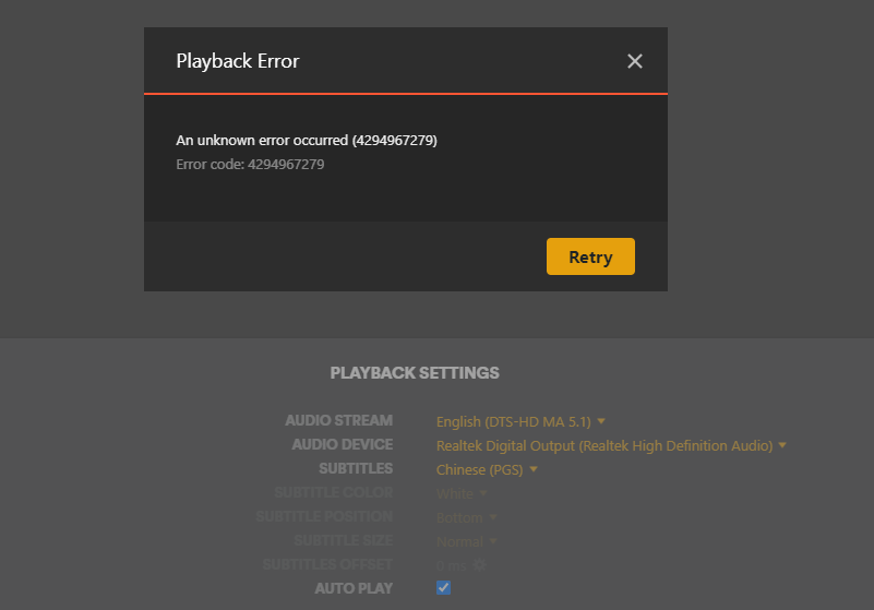

When I try transcoding to play a movie, I get error 4294967283.

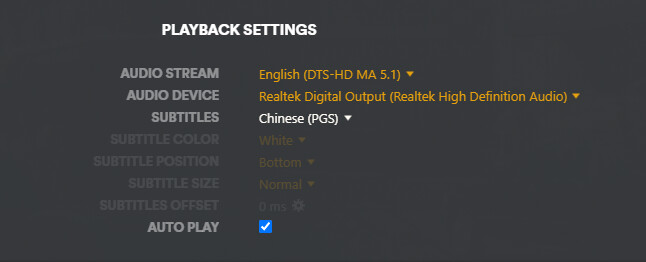

But I encountered a new problem,
There is no transcoding option on the playback interface
Sometimes they can work, but used cpu, Very sluggish.
Sometimes error
