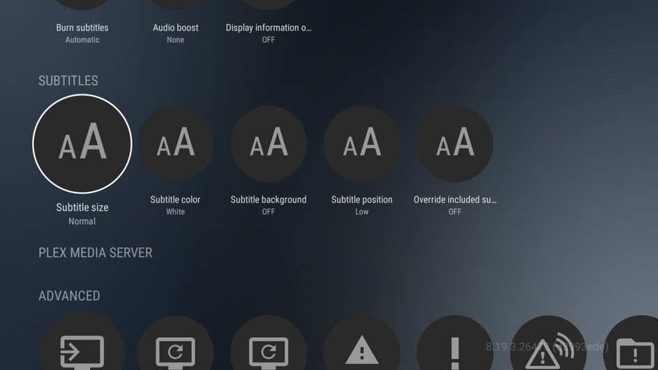

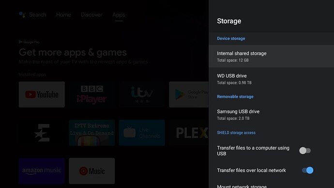

Plex media server is now using 9gb of storage on my nvidea shield Pro and I want to move it to my USB ssd. However, in the plex media server row in the settings there are no storage locations to select even though I have a 2tb ssd set as removable storage and a 1tb drive set as device storage. How do I get plex to recognise  my storage and move it? Thanks.

First picture shows the drive configuration,
Second picture shows that plex has created a folder on one of the drives.
The plex screenshot shows that nothing is select able under the plex media server tab so am unable to allocate storage

Your last image would imply Plex Media Server isn’t running. So I’m not sure how you are able to access it to play content.
