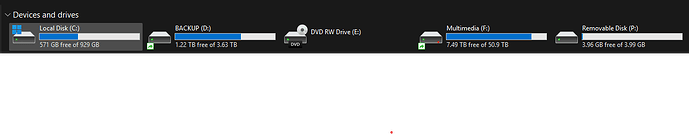

That is weird because I have so much space on my Server.
Is there anywhere in Particular I am supposed to clean something out to create space?
I set P:\ as the transcode temp directory, and as you can see, it is empty.
Thanks.

Is your P drive a USB stick or a RAM driver? In either case 4 GB is not really sufficient and it looks like permission or corrupted.
Not a good practice to point Plex at the Root of any drive.

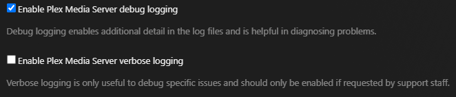

If you can still access the Server Settings {wrench} Server > General , logging should only be:

I agree with the above. Don’t use a recoverable drive for the transcoder folder. Plex exists these files to get created fairly quickly and your drive may be too slow. Also don’t use the root folder.
It indeed is a RAM driver and has been functioning flawlessly for years. I had even increased it to 12GB and it resulted in the same error.
I later on changed it to my C:\ drive and not the root, and it still provides the same error. Thanks for pointing out the network part. That was indeed wrong. I have since corrected that.
