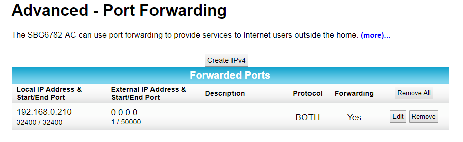

this is my port forward setup
why will this not connect
It looks like you have 50000 ports forwarded to your QNAP, if and only if 192.168.0.210 is your QNAP.
You’d need one port open for the Qnap remote (https? 443)
and one open for Plex, port 32400/32400
Then just to make sure, in plex settings, enable the ‘manual port’ checkbox and type in 32400.
Do you have any other router/firewall between your QNAP and that SBG6782-ac device?
