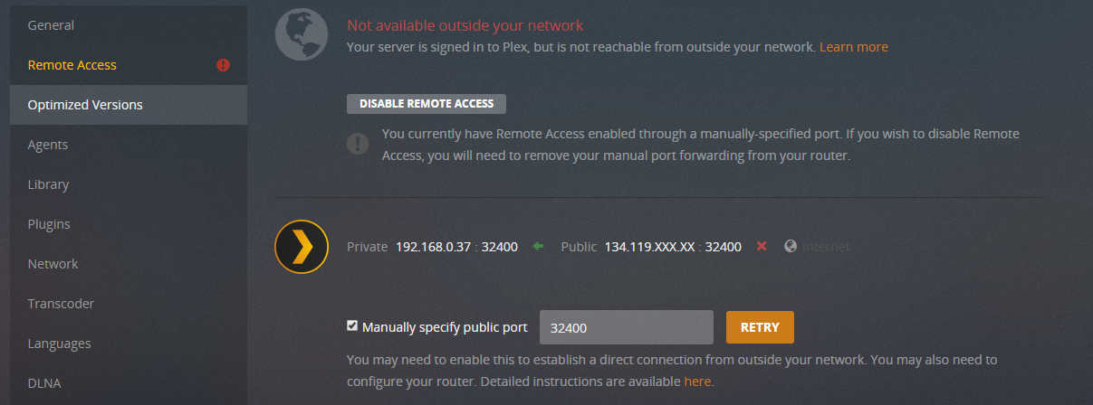

Here is the VPN control panel:
A yougetsignal.com screenshot:
IP3
And the Plex server:
I hid the end of the IP, but it’s the same one every screenshots :confused:
Is there something I’m doing wrong ?
No you got it right. Can you try a different location by disconnecting your VPN and connecting to a different location and creating a port forwarding rule for that location and connect your VPN to that location and test again?
