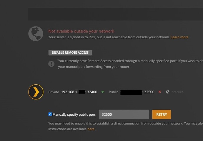

I have included a screenshot showing the Plex remote access information.
I have quadruple checked that the Public IP shown on Plex is the correct public IP for me and the internal IP for the port forwarding is the correct IP for the QNAP.
But each time I manually set a port…the remote access tab shows it’s available to the outside world…for 30 to 60 seconds and then it drops back to “inaccessible”.

Oh, sometimes when I come back to the remote access tab, everything will be green…but then it will drop back to inaccessible after 30 to 60 seconds.

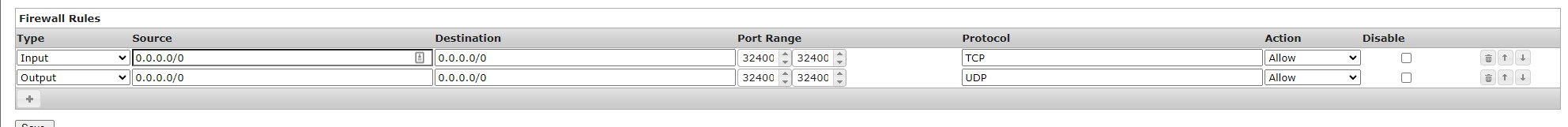

Please show the Firewall Rules tab of that settings screen instead of Status. Also, if you’re configuring something in the “Public IP” section of that screen, don’t. Leave that blank, or set it to whatever value on your firewall which means “don’t restrict by remote/public IP address.”

I didn’t update the firewall rules for the test on 32500…but the response is the same over both ports so that seems pretty definitive to me that what is happening here isn’t over-riding or negatively impacting my port forwarding.

are those your firewall rules or a port forwarding rules?

I suspect you forgot to add the Plex.tv hosts (which are what test for Remote Access)
through your port forwarding & firewall.
In your logs, you’ll see reachability tests.
reachability :0 == not reachable (no remote access) RED indication shows.
reachability :1 == reachable (Remote Access works) GREEN indication shows.
When you enable port forwarding, PMS sends the request to Plex.tv.
Plex.tv attempts to connect using your WAN IP and the port you assigned (or UPNP).
If there is connection, Reachability returns “1” (True)
Also in your port forwarding, there is no need for UDP. Everything is TCP.

The port forwarding screenshot appears to show that all TCP and UDP traffic that the router receives on 32400 goes to the NAS internally. This would seem to me to be regardless of source.
The firewall rules appears to show that all traffic inbound and outbound on 32400 is “allowed” with no IPv4 address limitations either internally or externally (I have IPv6 turned off on the port the QNAP server is communicating on, so only IPv4 would seem to matter).

Dave,
  1. You are correct. It’s showing all TCP and UDP traffic for port 32400 to go 192.168.1.x You do not need UDP. Recommend changing to TCP only.
  2. Port 32400 is extremely well known. People try to break into port 32400 all the time. I recommend something really odd in the range from 10000 → 65534
    (A birthday works well… e.g. 14-March-1990 → 14390). Mathematics is my hobby, I use a prime number :slight_smile:
  3. The firewall is only used to control INBOUND traffic. All traffic outbound is allowed by default unless you block it – else you’d have no internet connectivity.
  4. My concern is about what appears to be a list of Allowed IP addresses…
    – It allows only those listed to connect to you that you want.
    – The problem is it doesn’t allow Plex.tv to connect to you for testing
    – Do you really restrict access to a list (which you blocked for privacy) ?

Plex.tv hosts will connect to your EXTERNAL port (the one you forward) . The port forwarding handles delivering to internal 32400 where it’s expected.
