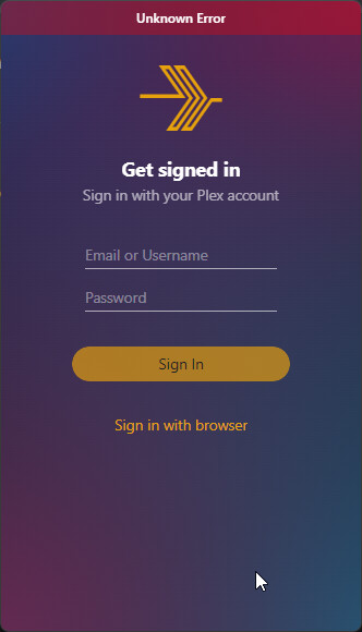

Unable to signin on Windows (Unknown Error)
I get the following error when trying to click Sign in with browser or use username/password.
I have two internet connections to this computer, but only have one adapter active at a time.

I have deleted those directories and reinstalled the app, but the exact same error persists.
I have switched to Wifi and used hotspot but still get the same Unknown Error.
Switching back to the original adapter (behind proxy) it will see the internet again and connect, but I can’t use this because as mentioned, it can’t see the server on this network.

Pressing the “Sign in with browser” causes the “Unknown Error” to appear.
The browser does not launch with the login url due to the error.
