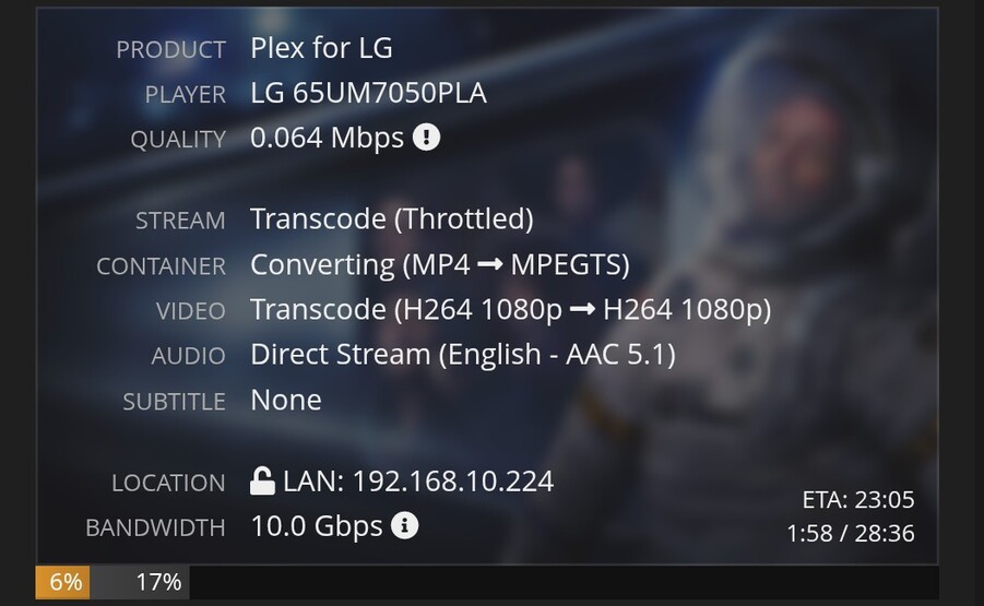

Why is this mp4 file, which is direct play compatable with my LG TV being transcoded to a 10Gb stream with no change of Audio or Video formats…

It you look at the window:
  1. Audio = Unchanged
  2. Video = Unchanged
  3. Container – Convert from MP4 → MPEGTS.
    – This is a REMUX-only
The TV app wants the audio & video in a .TS container.
The 10 Gbps is the degenerate case PMS reports then only the container changes because neither video nor audio is changing.
In most cases, PMS will make this conversion on its own without the transcoder.

and this is the only file that does this. It happens on both my LG TVs, but does direct play on mobile and desktop systems…
I’m only running Plex on a Pi4 and this one transcode kills the whole system CPU wise with the stream stopping every 20 seconds or so
