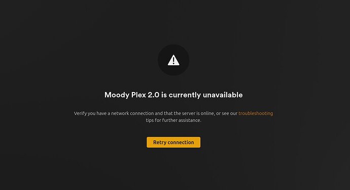

Yesterday I added a couple of movies and TV shows. When I tried to play them nothing was working. So I logged into my Server and noticed there was an update available, so I downloaded and installed it. Then I had a partial upgrade for Ubuntu, 24.04.3 LTS. After those were both complete I restarted the computer, when it came back online and I opened Plex. I was required to login in again, and Plex wanted me to create a new server instance. My established Instance says unavailable. My first thought is that I need to reclaim my server, but I am not sure that is the case.

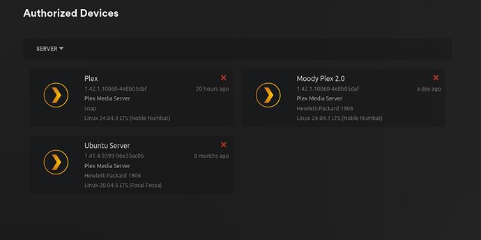

I see 3 servers, one is old (I had to replace the OS hard-drive) [Ubuntu Server], the one I want back [Moody Plex 2.0], and the one Plex tried creating yesterday [Plex].
It looks like it is claimed.

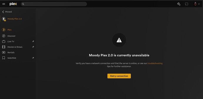

It shows the server I want to connect to on my list of servers, the only one that is working is the one created yesterday after I updated the server.
@obiwansean
Looking at your Plex.tv account, I see three servers.
They all have the same LAN IP (192.168.0.13)
Is there any particular IP/name you want to keep
( I am offering to clear the others for you )
I see “U…”, “M…”, and “P…”

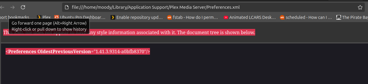

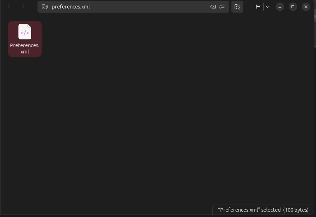

When I look up the Pereferences.xml, this is what I get.

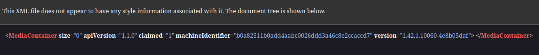

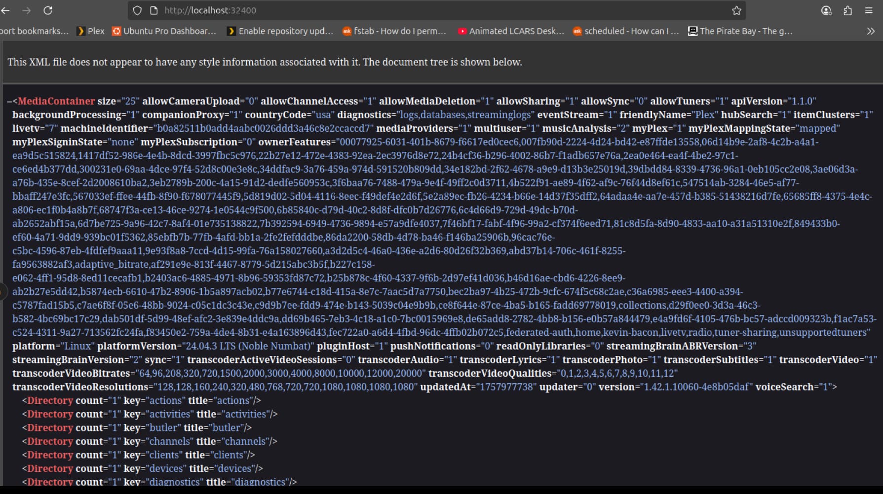

This is what I get when I try to go to localhost:32400
Please tell me where to stop if I need to:

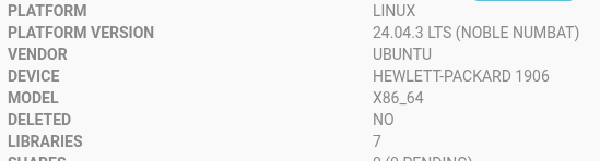

What I see on Plex.tv is you didn’t install the DEB package.
You installed the SNAP package (sandboxed version)
Vendor Ubuntu
Device snap
Model x86_64
Deleted No
Libraries 0
Shares 0 (0 pending)
Presence Yes
Do you have the .DEB file you previously used or would you like a link?

setup new server, Moody recover, and the libraries were recreated. The Moody Plex 2.0 still says unavailable.

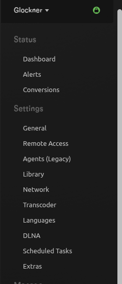

Settings - (upper corner) Authorized Devices - Server (dropdown) … you can delete the old one
Rename “Moody Recover” in Settings - Server - General - Show Advanced
Don’t forget to go through ALL your settings to put them back to where you had them. This instance has no knowledge of the previous server.. You’re running on defaults at the moment.
