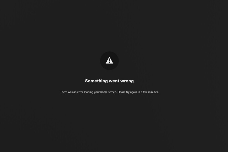

When I log on after the upgrade, I see this error message:
