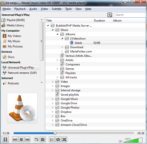

You should also be able to enable the DLNA server in Plex Media Server then use a DLNA client on your various devices (VLC, etc). It is not as friendly as a Plex client, but if you know which video you want to watch it is easy enough to navigate up/down the directory structure.
