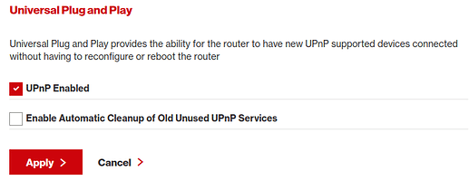

First option: (Preferred)
You can set up port forwarding for both servers automatically using UPNP.
On your router, go to Advanced → Universal Plug and Play and set it up as below:
Do not leave the second option enabled
Once this configuration is applied, disable and enable remote access on Plex and it will configure everything by itself.
