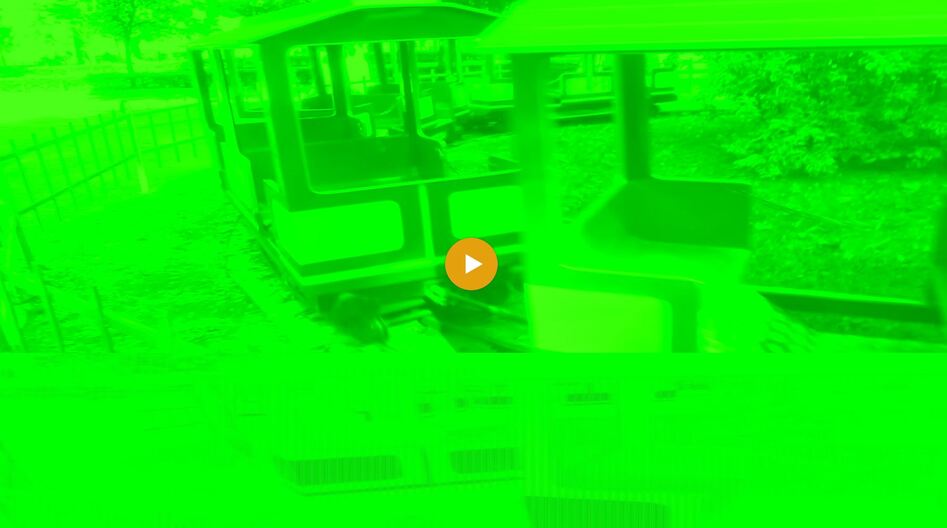

Since I forgot to put a screencapture to display my problem here is an example so you can better see why I use VLC for now instead of Plex :confused: :
Z.
OK, that looks like a classic hardware acceleration problem.
By “display adapter” I meant “video card”. Nvidia? AMD? Just what’s on the processor?
When’s the last time you updated your driver?
Try turning off hardware acceleration in the app settings. The checkbox for that is under Settings > Player > Use Hardware Decoding. Uncheck it and see if anything changes.

Oh by the way, I just unticked the Hardware decoding and it worked :slight_smile:
Thanks for saving me man, it hepled a lot !!

The data from the video file needs to be processed into a form that can be displayed on what it is you’re playing the title on. There are two main ways for that to happen: A) let the CPU handle it in software, and B) let the video card handle it in hardware. The hardware in the video card is designed specifically for this purpose so it’s much faster at the job than the CPU. Using hardware decoding also frees the CPU to handle other things more efficiently. Therefore, in general, hardware decoding (also called “hardware acceleration” in some programs) is greatly preferred in most circumstances.
In your case, however, the video card in your system is a little . . . uh . . . weak. That 5450 is >10 years old now and just isn’t up to the demands of heavy video decoding. It’ll work fine for a lot of things like word processing, but it’s choking on the amount of data being thrown at it when you try to use it for PLEX.
There are two big clues that tipped me off to the hardware decoding issue. First is that the output goes to one color. That’s a classic sign of a decode failure. You’re only getting one color channel. The other hint was that things played fine in VLC which has a different approach to hardware decoding than PLEX does.
You might want to go to the AMD site and get the latest drivers for that card. Sometimes that’s enough to let you turn decoding back on without issue. Sometimes the card is just too old no matter what.
