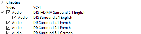

Here is a screenshot from MakeMKV. The English audio (US disc) is in dts-HD MA 5.1. The second, inset entry is the same audio track, but in dts 5.1 format. Discs with TrueHD & Dolby Digitial look the same (with DD inset). Any commentary, etc tracks are not inset, the same as the French, German, etc audio tracks in the screenshot.
Screenshot (128)
