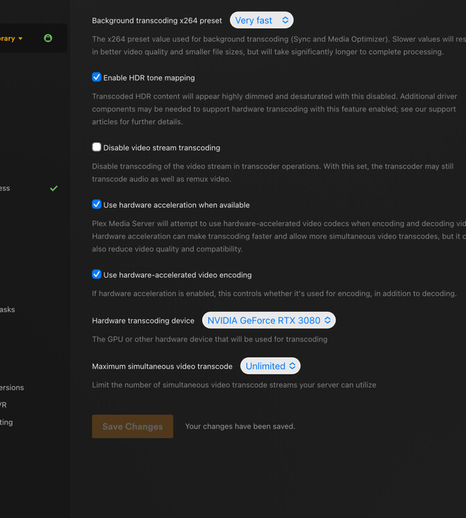

On the section “Hardware Transcoding Device”, Try changing it from “Auto” to the actual HW device your using in your PC to HW transcode. I had a similar issue with HW transcoding when using a gaming PC with a RTX 4060 before moving to M2 Mac. Once I changed “Hardware Transcoding Device” from “Auto” to “RTX 4060”, HW transcoding started working again.

Ok I changed it! I have a RTX 3080 so hopefully it will fix the issue. Overall I’ve never had any problems with video transcoding on any other devices just my TV’s LG CX Plex app.
Restart your server before testing
I only suggested this change because I had a similar issue where Plex would sometimes fallback to a Software transcode for the video when trying to transcode DTS/TrueHD audio, Even though I had HW more than capable of HW transcoding the video. Obviously the audio will still be done in SW, But with the HW taking most of the heavy 4k lifting, Hopefully this might solve the issue for you.
Switching it from Auto to my 3080 did not fix the issue. I made sure to restart my server. I’ve found a couple other thread topics of people who have had this same problem. Hopefully Plex is aware of it and is working toward a fix
