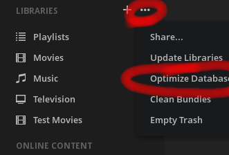

I’m seeing a lot of server issues first. Your database is in need of optimization. It has become slow. This is an unfortunate side effect of this database type . The butler (Server - Scheduled Tasks) does this for you each 3 days.
To correct for you immediately:
Go to the ellipsis (***) near Library and click “Optimize Database”.

To do this, we must Optimize the Database.
You have two choices:
Either you do it here:
or you use the command line as I have tried to instruct. I will capture screen shots to help you if you need.
