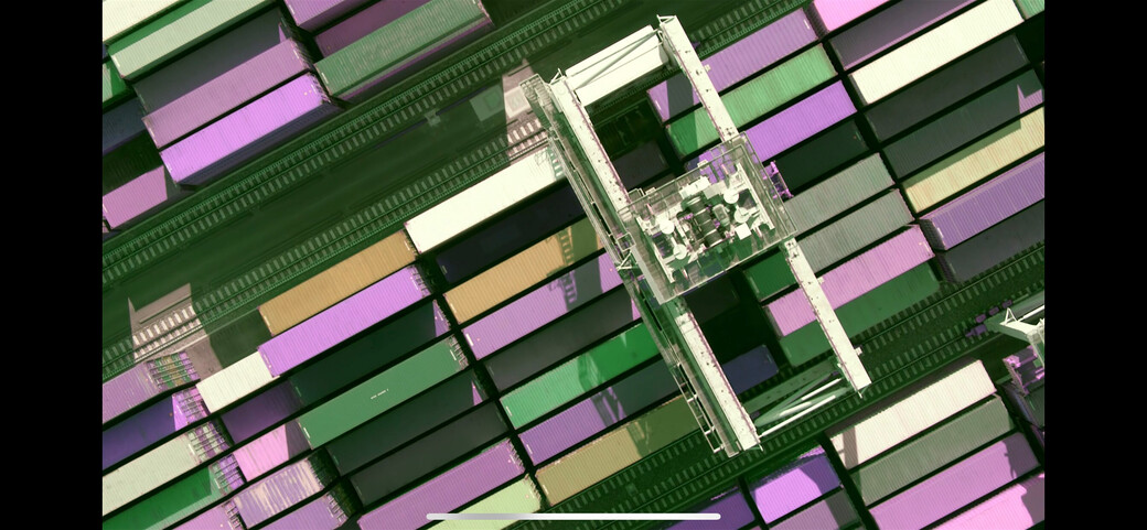

Wow, new issue with Dolby Vision playback. Not every DoVi 5 MP4 actually works - some trigger Dolby Vision, some don’t whilst the included LG WebOS player reads both files correctly. Weird stuff.
Yeah none of my Dolby Vision files play properly on AppleTV 4k, Plex App (Mac), or Plex Web Player. Are we sure this is stuff actually supposed to work on anything other than Nvidia Shield?
There’s some example DV video files available here: ¦› 4K Dolby Vision video test | Amaze, Art, Clocks, Container
None of those play on any of my players without severe color issues like this (on Plex):
and this (on Infuse):

Thanks for the quick reply! AppleTV 4k is DV capable and my display (LG OLED) also is. As for the Plex AppleTV app not having support, at least according to the release notes below, it seems like it got it back in Dec.
Maybe that statement means something different than what I am thinking it does?
It does.
Other than a small minority of DV files with a particular profile , Plex on the ATV 4K simply forces the ATV 4K into Dolby Vision mode.
The same can be achieved watching a 20 year old SD episode of any random show if you choose the right settings.
What you are seeing is an icon saying you are seeing Dolby Vision.
What you aren’t seeing is Dolby Vision.
I have an LG too
Hmm so there are DV videos that play on ATV properly? I have 6 or 7 but none are actually playing correctly. Plex media server definitely parses the Dolby Vision information from the video files properly and sets it in the meta info though.

I guess I would expect if it was trying to play an unsupported profile it should just throw an error indicating the file contains an unsupported profile rather than playing it incorrectly.
I guess it’s ok if this is an incremental step towards supporting more profiles but it would at least be helpful to indicate that the video isn’t supported. Or maybe at the very least to call out the profiles that ARE supported in the release notes so we don’t go around scratching our heads trying to figure out what’s wrong with our videos or if Plex is broken :slight_smile:
Also btw Apple TV 4k says it supports:
HEVC Dolby Vision (Profile 5)/HDR10 (Main 10 profile) up to 2160p
So it seems like this isn’t an ATV/LG issue but a plex support issue I guess.
