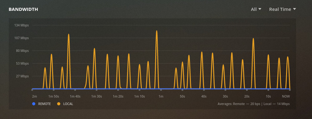

What's up with PLEX's bandwidth usage (local and remote), it tends to use 2x more than it should?

I genuinely believe something funky is going on because every time I monitor stats for Plex, its very unstable. It almost always state the playback bitrate at 2x the average bitrate of the source file too. For example when playing Twilight 4K UHD HDR Blu-ray, it stated 200 Mbps, yet the file is 80 Mbps average. Even for something lightweight like a 1080p SDR AVC file that is 50 Mbps, it stated it was 120 Mbps.
If I look at stat graphs while playing videos (either me or other people) it is incredibly unstable, alternating from 0, to something, to 0, to something, on repeat sometimes 0 being 1 or 2 Mbps.
Something is clearly wrong here. Both Emby and Plex for these tests were never used simultaneously other than the comparison video, even then you cannot say Emby was given special treatment because Plex had it’s play button clicked noticably first.
The bandwidth chart looks pretty normal.
  • The client downloads a portion of the video to the cache. This happens as fast as the network and device can support.
  • Then the client decodes and plays from the cache.
  • Eventually the cache gets a bit low, so the client downloads another chunk into the cache, as fast as possible.
  • This is further exaggerated on devices with large caches, fast networks, and low-bitrate video. My TV can download a big portion of a low-bitrate cartoon, and only grabs a new chunk every minute or two.
But that’s not to discount your complaint about slow startup or failure to play. Those deserve investigation.

Deep analysis will influence which stream is selected for playback, and the decision to transcode or not, but it doesn’t affect the bandwidth chart on the dashboard, or the download/buffer/playback cycle once things are playing.
My point is that the video isn’t streamed smoothly at the video’s bitrate, chunks are downloaded into the client buffer as fast as possible. Bursts in the bandwidth graph are normal, will occur whether deep analysis has been performed or not, and don’t indicate a playback problem.

I probably should have been clearer as to what I was referring to. Specifically, I was referring to the bitrate shown in the playback information on the dashboard; which is what I, in turn, assumed the OP was referring to regarding what PMS stated the bandwidth was.
At any rate, deep analysis does impact that. The movie from the screenshot above reported 5 Mb/s before I forced it to be deep-analyzed.
Also, I completely agree with your earlier statement that the bandwidth chart looked normal; that was my first thought looking at it as well. My post was mostly intended to explain why the reported stream bitrate was normal as well.
Hopefully I didn’t introduce any confusion as to what deep analysis is actually going to accomplish and how it will (or won’t) impact streaming.

One thing I have noticed time and time again in all the discussions is that PLEX seems to absolutely pile drive the content from the server to the client. Perhaps that is what emby is doing differently. Perhaps instead of doing a buffer-fill asap style, they instead perhaps smooth-stream the content i.e. send small chunks as the user plays the content, instead of trying to fill a x amount of seconds worth of content into a buffer, and instead tries to fill x amount of bytes as it streams. Perhaps the client requests the amount of chunks it wants instead of the server pile driving it down it’s throat.
It’s possible the PMS shoving it down its throat is stifiling the bandwidth available to the server while its doing that, causing it to seize up for a bit, which then dominoes into buffering issues as it tries to resolve itself, but then the client tries robbing lots of the recovering bandwidth?
In Plex (and Emby and Netflix and every other common player and service) the model is that the client requests chunks of video, and the server delivers them in response. The client starts decoding and begins playback as soon as a minimum threshold is reached, and keeps requesting more video until a buffer-fill threshold is reached. The client then plays from the buffer, and requests additional chunks when a low-water-mark threshold is reached.
Different devices obviously have different maximum buffer sizes, and different software sets the “start playing” and “get more data” thresholds differently.
Not saying Plex is working for you. Or that it’s better. Just there’s no “pushing”.
