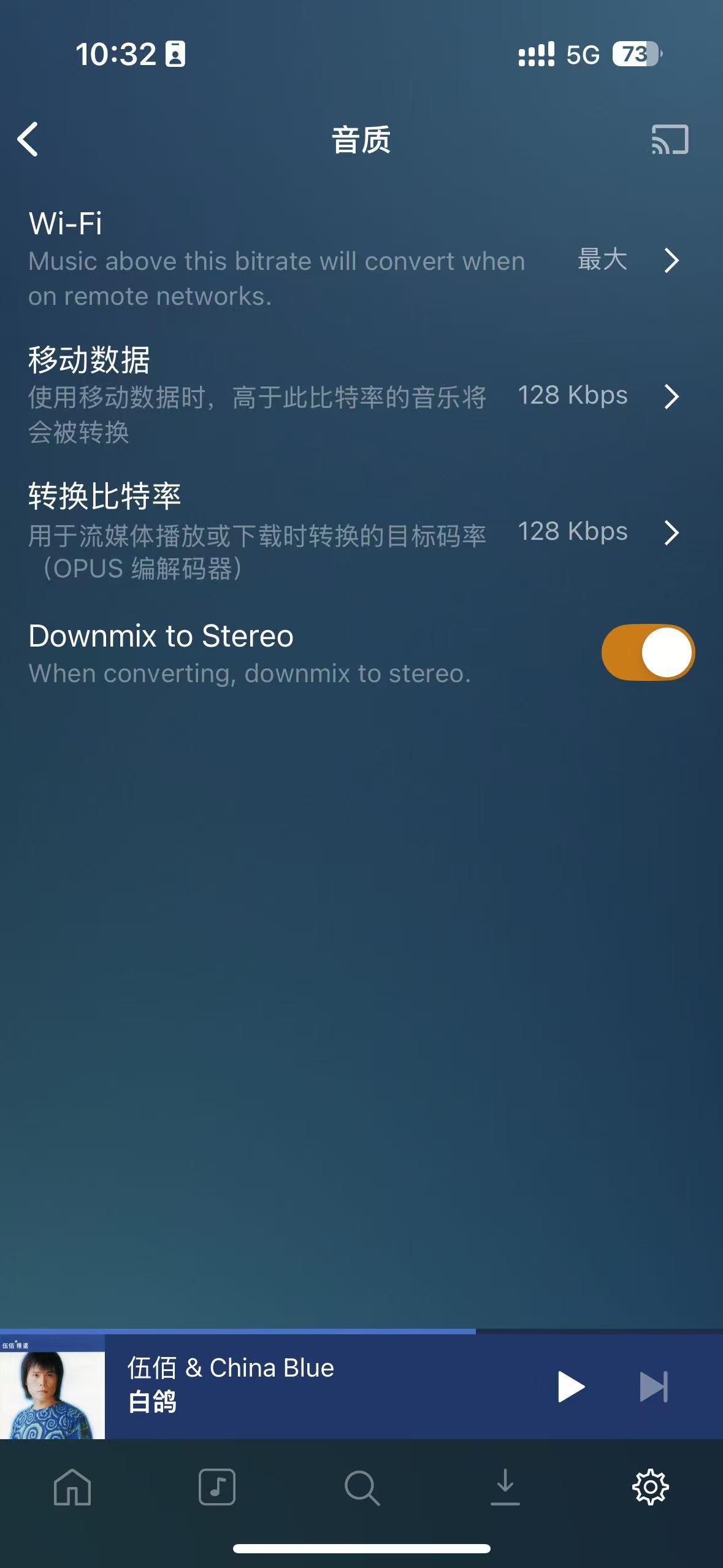

I haven’t heard of instances where the Opus transcoder is failing. If you’ve changed the conversion bitrate try the default value.
