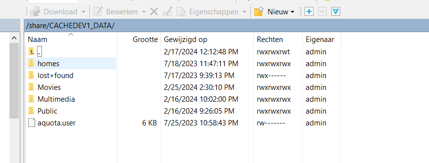

I use winscp. I am logged in with admin account
and this all what 's in the folder you mentioned:
Do you think it has anything to do with the proper rights
You need to enable hidden files/dirs, as well as use SFTP
See: Qnap faq.....read me first!
Yep. I see it now.
Q15: Adding a plug-in from a Windows workstation
If running WinSCP then make sure that you have enabled to show hidden files and folders (Ctrl-Alt-H). Also make sure, that you connect using SFTP!
I should have read the FAQ better.
