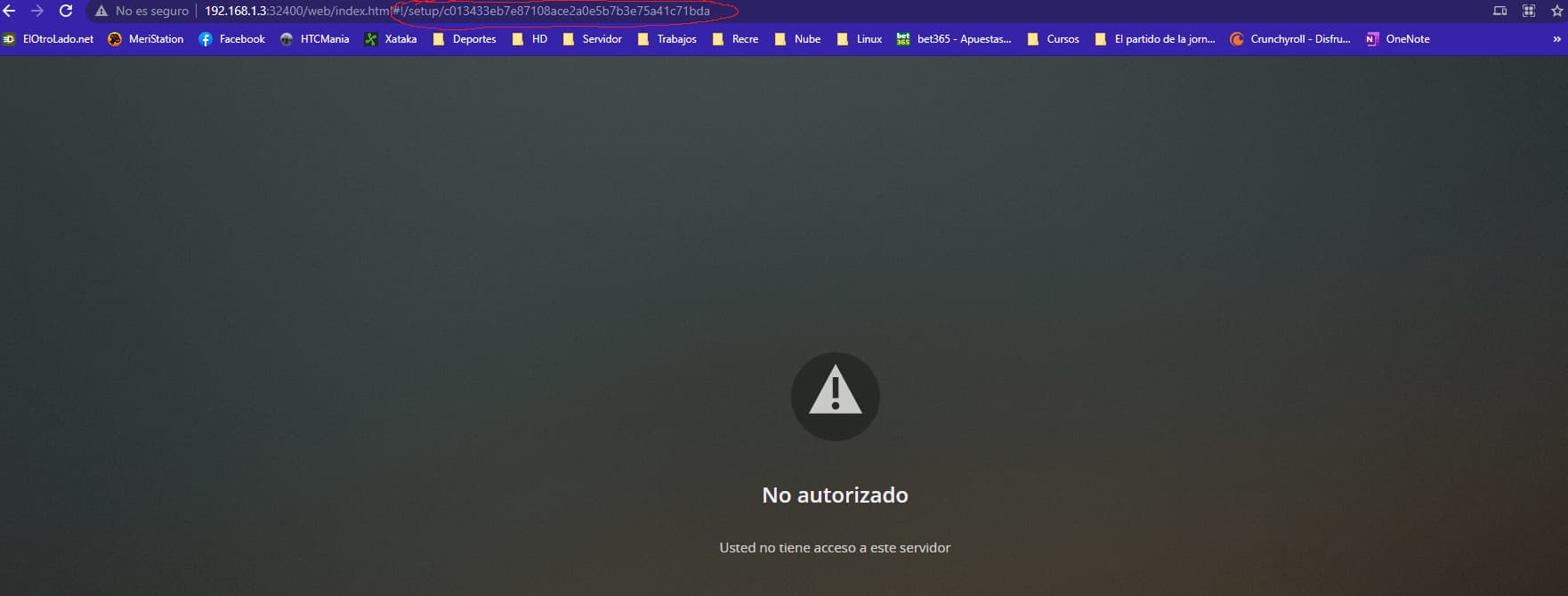

When i join http://192.168.1.3:32400/web (raspberry ip and i try to change it to http://192.168.1.50:32400/web too and same issue) i have the next screen:
If i delete the “#!/setup/b3576f6d6f0ff82f84b568d42cbc5acaf8aa7ef1” and click enter, i can join but seems that is the player version, i cant add a server or library:

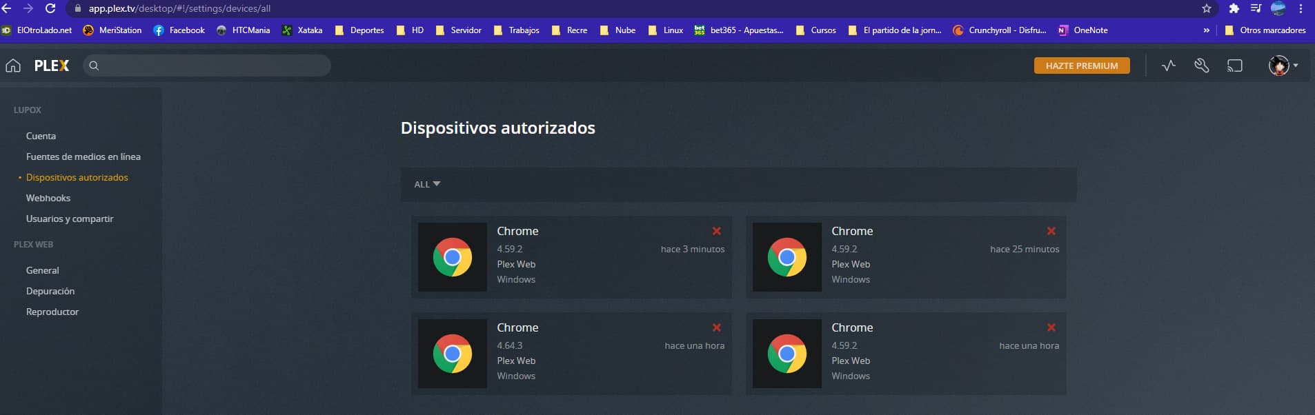

This is my App.plex web
I have no options for configure anything of server.
